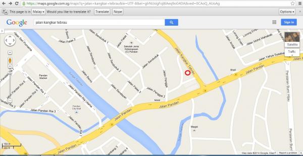

There is a motor shop at a place called Kangkar Tebrau in JB - Its after the Pandan City place. You'll bypass a petrol station (Petron if I'm not wrong. its blue with red strips not Petronas which is green). You can go there for cheap parts.
The racing boy rims are about RM180 there, if I'm not wrong.
This shop was recommended to me by someone from the FZ16 (fazer) group.
Kindly refer to the photo - the location is the red circle...
The shop has a white empty signage on top.
This place is cheaper that Jalan Bapok a.k.a Ah Gua Lane. locals call it Jalan Susur (which is the correct term) - there the racing boy rims are 20 - 40 RM more expensive.
Difference? with racing boy rims can go tubeless... much easier if kena puncture somewhere - just put "worm" can still limp back safely. I wouldn't recommend the 3 spoke racing boy rims for heavy people though, someone I know broke the spoke when he had a harrd hit into a lobang in the road, however it is good in a sense that is is lighter... so, plus points for weight saving and handling...

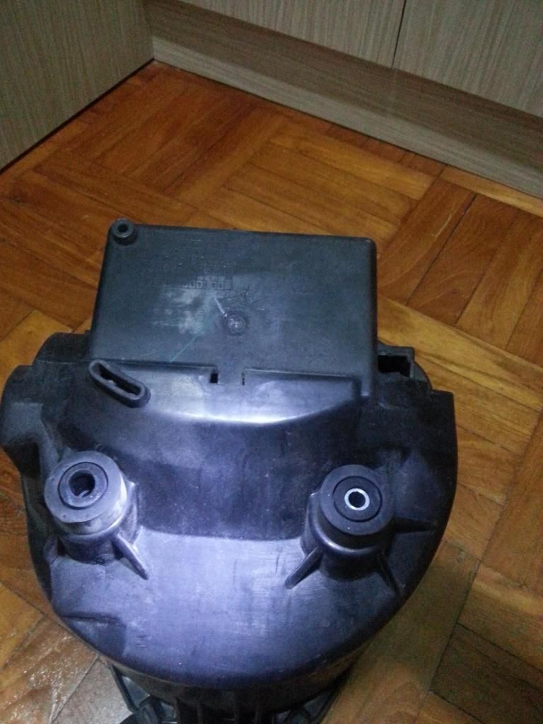

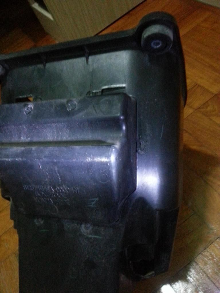

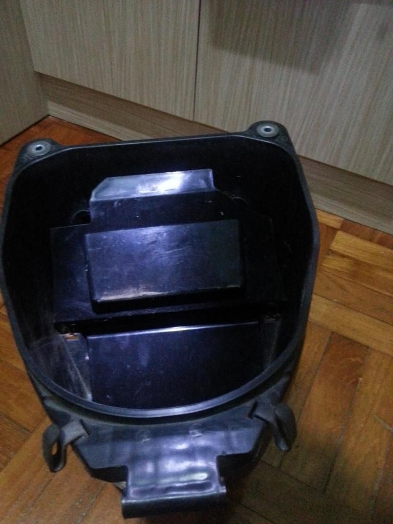

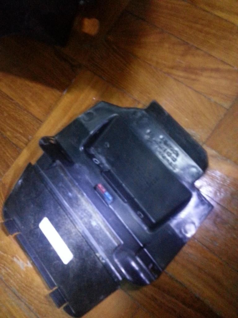

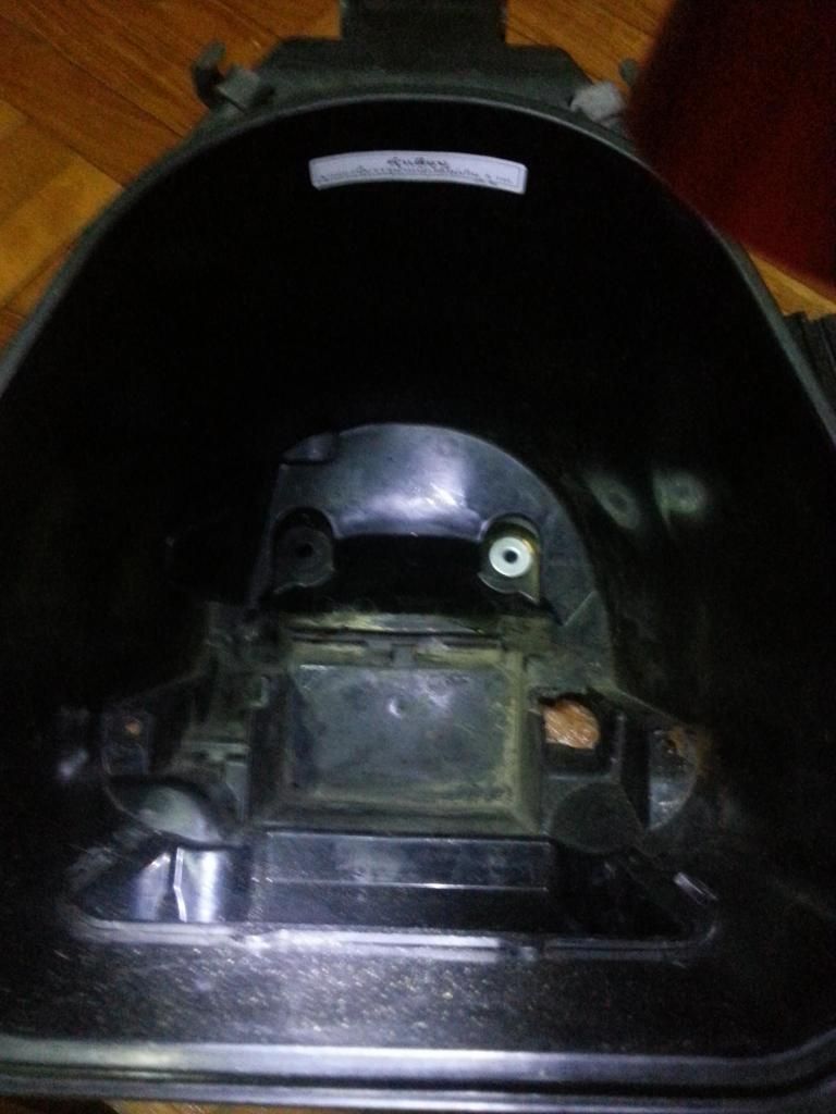

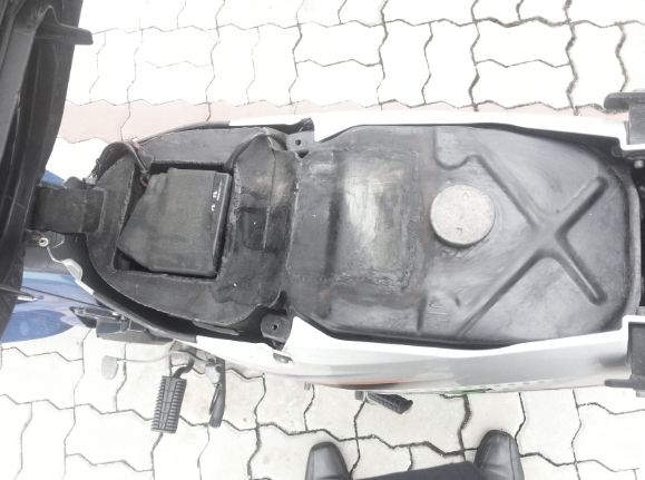

Here you go. What you see is what you get, maybe a washer, or a rubber standoff or something is missing, but then again, i just chuck them in my junk box.. so yeah..
Just realised there's spare fuses in the battery compartment.. lol.. if i didnt take the pics i wouldnt notice it.
http://i759.photobucket.com/albums/xx240/giamhe/20140108_230735_zpse299e878.jpg
http://i759.photobucket.com/albums/xx240/giamhe/20140108_230835_zpsb965c151.jpg
http://i759.photobucket.com/albums/xx240/giamhe/20140108_230809_zpsf56afd44.jpg
http://i759.photobucket.com/albums/xx240/giamhe/20140108_230753_zps7657329d.jpg
http://i759.photobucket.com/albums/xx240/giamhe/20140108_230819_zps4d953601.jpg

xianyu87,
you kilat man! hahaha...
btw, many thanks for the pics - at least now we have an idea what was not involved in the surgery... :clap:
from what I see, only the u-box was unaffected/unmodified. basically the fabricator just removed it and used the space for the tank expansion.

Guys, just wanted to chip in. so there wont be need to speculate, Just hope to help out people with questions. I have done mine rather recently, Late 2013. Think can find it in previous posts.
Kranji Quoted me 400. Didnt do there.
Damage = 350
Shop = Kaki Bukit
Expansion, not a replacement tank
Capacity = 11-12Litres
Material = steel
Treatment = black paint/coating outside, internal chemical coating for rust prevention (white color coating)
Features = Custom Slot for Battery
Waiting Period = Approx 1 week or lesser
Fuel Gauge = Works and accurate imho, (the gauge is mounted in the battery compartment, so its below the top most of point of the tank, therefore for the first 3-4 litres, fuel gauge shows full, only after the 3l mark, the fuel gauge starts dropping accurately in proportion to remaining fuel, when fuel gauge shows TOTALLY empty, i still have 1.5l left.) Hope you guys can understand what i mean.
You get back :
1) U box
2) U box metal bracket with the helmet hooks
Cons:
Stationary push/pull seems abit heavier, very very slightly. Most obvious is when you just pump and put in on mainstand.
Moving off, with pillion or without, no difference in power or pick up(by butt dyno)
Gas efficiency decrease by 2-3km/l, original i was hitting 50km/l roughly, now its 48km/l.
Loss of U box, but i have top box, so nevermind
Loss of helmet locks, same thing, topbox
I believe you can ask him to weld the hooks back on at additional cost.
Conclusion, For me its a well worth investment, i clock 60km a day to and from work. use to pump every 2days , scared of running out of gas in tuas. now i pump once a week.
No complains, no rust, no nothing, not obvious to tp too. so yeah.
further questions can just shoot. I will try my best to answer.

yo simple rider.. paiseh last night not free..
but i keep my words.. :p
here you go.. as you can see the fuel sensor is under the battery.
one pic is the general top overall view..
one is specifically in the battery compartment..

just want to add.. ya wires looks abit messy.. but i have never had any problems be it rain or shine.. and i ride during very heavy rain too.. soyeah.. plus he does shrink wrap your wire connections..
the rubber tube is wrap around the battery so no chattering will occur when you ride.. yeah.. dont by shop's own initiative..
all in all.. after doing it.. no problems faced.. aesthetics not as good as stock tank.. shiny and all.. but well it works for me.. and thats what matters to me..
