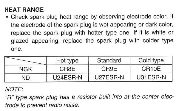

Manufacturer recommends CR9E for mine as shown in attachement.
I know what spark plug part number for mine.
Its a matter of the heat rating and whether a 'hotter' plug will have any adverse effects on the engine.
As shown in attachment, there is a risk of running too lean when changing to a 'hotter' plug.
But is it a confirmed occurance?
