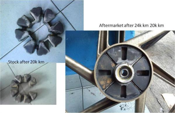

i still hv a new set of Sinnob UG3 4 Holes Orange color chain in stock selling $100 only (local shop selling $150)... free goodies and a damper rubber coupling (stock $11.50) comes along wif it .. pm / watsapp me if anyone intrested ...
[ATTACH=CONFIG]251061[/ATTACH]
noted chief mj
I intend to bring this Aftermarket Damper Coupling since few FZ16 guys intrested to get theirs ... if u guys tag along with this round price will be $9 a set !! ...
watsapp or msg me to confirm n for payment by this sun ....
