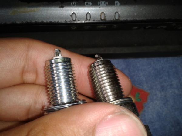

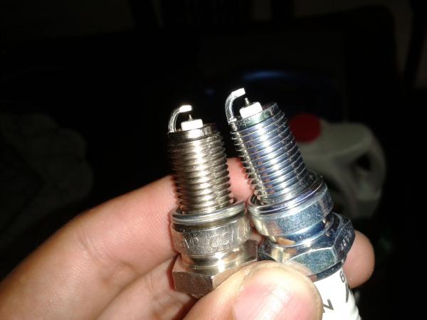

Silver coloured plug is ngk iridium dpr8eix
nickel coloured is denso iridium IX24B
Denso good to go 30 000 km
NGK 50 000 km
Denso 0.4mm tip
Ngk 0.6mm Tip
Denso have a patented U groove ground electrode
Denso Better packaging tight plastic to protect.
Ngk crap cupboard to protect.
Both Plugs made in Japan
From the box.
NGK overtightened terminal Nut
Denso easy to open.
NGK more popular and easily available then DENSO.
