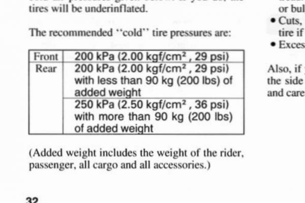

  shing said:
Thanks for the reply. How about tyres ?what is the appropriate tyre pressure for front and back?am on a shadow 400 with side boxes:)
Bro for tires the side wall will have indication on the recommended pressure values.
For manual recommendation, please see the attached screen shot.ImageUploadedByTapatalk1410696951.954243.jpg
_____________________________
Pardon me for typo error as this is sent by mobile.
-= Ride to Freedom, Freedom to Ride =-
For manual recommendation, please see the attached screen shot.[ATTACH]311538[/ATTACH]
As cruiserian mentioned, it is best to pump according to the recommended pressure on the sidewall. i'm pumping 41, 44 psi (270, 300kPa) for front and rear tyres respectively.
