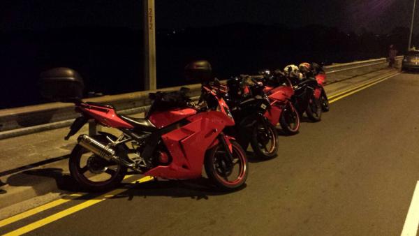

great night guys! had supper, talked, discuss about r125 at yishun dam till almost 5am hahaha
Riders who attend:
1) Tanner
2)Ismail
3)Marshmellow
4)Joey
5)Me
HOPE TO SEE MORE RWR RIDERS NEXT FEW GATHERINGS! GREAT NIGHT GUYS!
