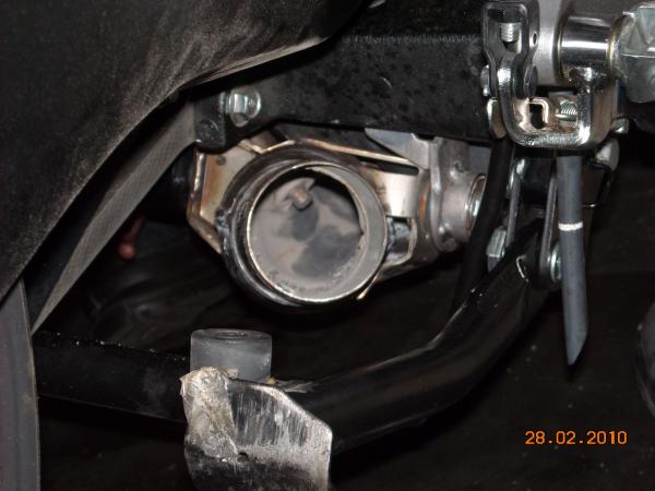

Exup? Whats dat? Btw decat is it legal or not?
I decat first then i installed my slipon & remove all the exup cables. On the same day i personally send for inspection.
Came back with a legal cert.
The cat is meant for US & Euro, in S'pore not so stringent. unofficially consider safe.
Pic below where the cat has been removed.
Just to share my experience.

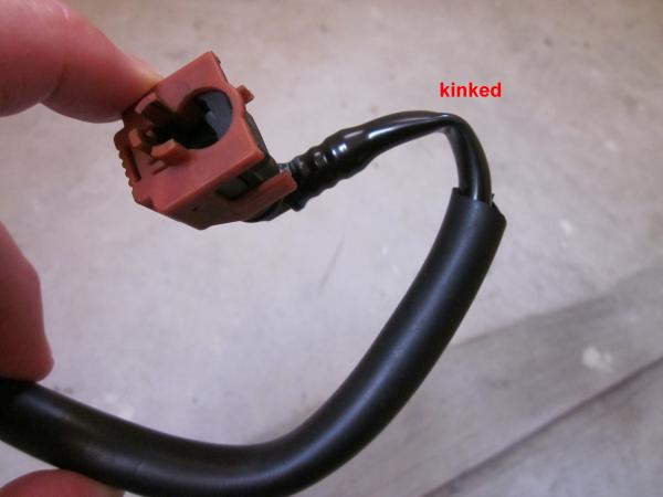

Gentleman when you close the entire fuel tank whether is by yourself or the mechanic, please make sure the fuel hose is not kinked like mine. This has resulted the surging & hiccups on my bike the last few days.
I have assumed was the FCE, after removed the FCE then found out the kinked fuel hose. Now the throttle feel is not as buttery smooth like before compare to having the FCE installed, especially at the 3K rpm & during warm up the auto-choke is extremely lound till temperature reached 75c. If time permit, will put the FCE back.
