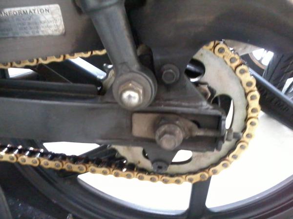

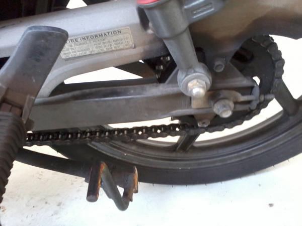

Before
After
More pics in my blog :)
Edited by Hydher
