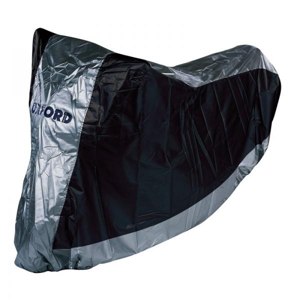

Anyone know where to get the bike cover with waterproof and last for heat? i got it from auntie shop previously, cost abt 30 or 40+ cant recall liao... but last abt 1 year lidat and now getting thin n spoil soon... tinking to change other brand??...
i believe the brand Oxford which came with quite a no. of huge size that is available at motoworld is good. perhaps u can give it a try on that?
it looks something like this :
[ATTACH=CONFIG]240644[/ATTACH]
Thanks info, btw any idea this bike cover will stick to the exhaust when is still hot?
