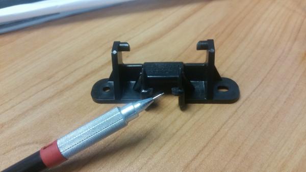

Hi Guys,
I just got a 2010 swt400 this morning.
The spring from the plastic fuel lid came loose and popped out (maybe to welcome me haha).
Can sifus here teach me how to fix back ??
Thanks.

Also i find when cornering, the rear is quite unstable and very soft (like got too much grip). Anything to check or adjust to improve stability ?
Thanks.

I have this issue few month back. One of the shaft that hold the spring broke. Went to FJT and order a replacement ($10). waited 3 weeks for the part to arrive. Make sure you still have the spring. If missing, must pay more for replacement.
Edited by speedcannon
[ATTACH=CONFIG]320297[/ATTACH]
Thanks for reply bro.
If not too troublesome can send pix of how the spring is to be attached ??
I try to fabricate the broken piece.
Thanks.

spring... first, you check if any part of the plastic lid assembly broke off.
if nothing is broken, maybe can squeeze spring back in. dunno how, can go AC Motor and seek help from Ah Choong... he's the handy man.
if broken, then consider replace lid, or can also live with no spring since it does not affect safety at all (can open and close properly can liow).
