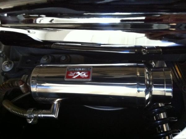

Hi bros, saw this on a GTS 200. any idea whats this?
[ATTACH=CONFIG]237271[/ATTACH][ATTACH=CONFIG]237272[/ATTACH]
In Taiwan there are a lot of upgrade parts, rear suspension is too soft for Singapore condition, show quite a few GTS fitted with oil damping shocks, so it should be available here except dunno what brand and where to get.
It has something to do with the airflow or air intake that circulate cool air to the engine and cools down the EO. A friend has this on his yamaha 150. Believe its from Yoshi.

Saw this lately on many scooter, but really wondering what its for? o_O
if i can remember clearly... Some use it as enginer breather, some use it as Air intake. I do once saw a old GTS with this device acting as air box. It can commonly found in G-max scooter & Runner. It cost around ~$100 -$150.

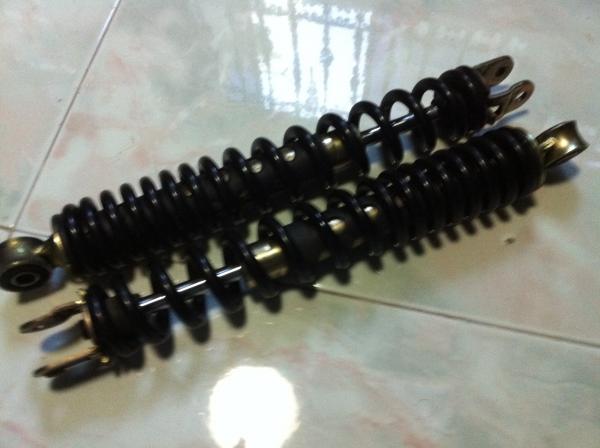

Hai, finally sold my aftermarket rear shocks to a close friend riding a Sym Evo 200i, chhers bro to your "2 mths almost new" shocks. I saw his stock oem right side is a goner, leaks oil, and taking high speed conering almost buang to self skid. Ride safe my frenIMG_1795.jpg
