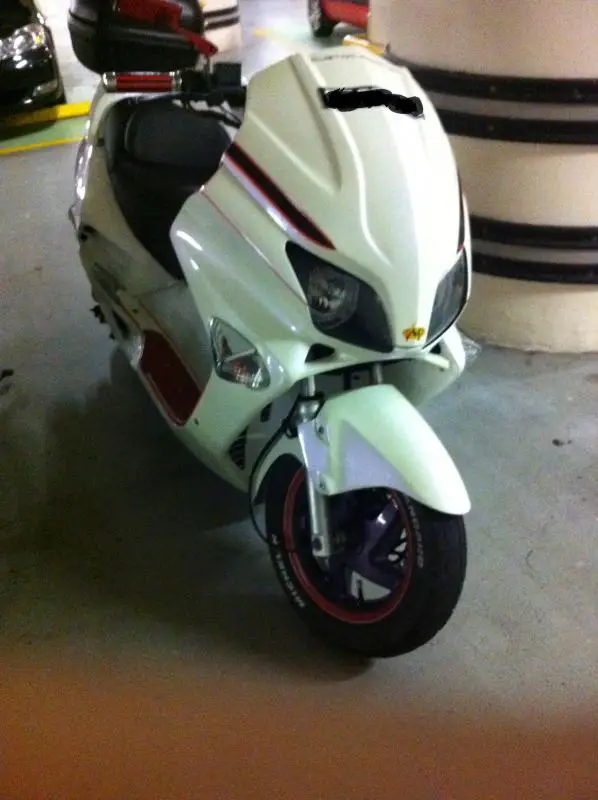

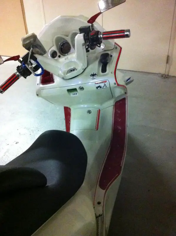

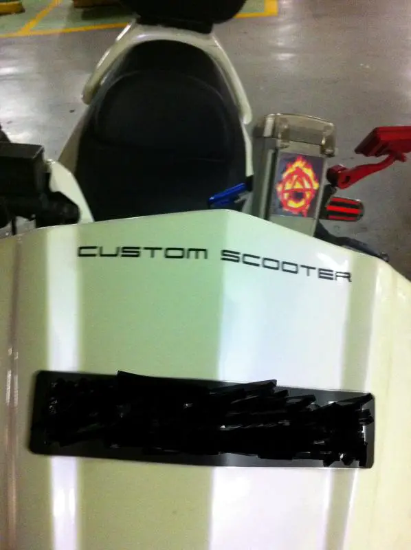

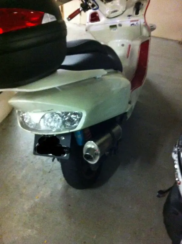

Has anyone seen this kinda bikes? It was kinda cool. Parked at TTSH.
