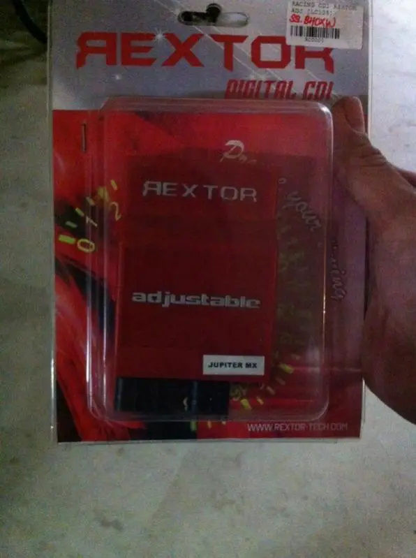

Im using rextor dualband.and yes apparently after i switch to my stock cdi,starting's a breeze.i double confirm by fixing the cdi on my friend's spark and his couldnt start as well.well i have 1 month warranty from shop.but gotta go over the causeway to claim.gotta claim cuz it cost 380rm :/
Shamoz, pls post a picture of the CDI because in JB, there's alot of fake Rextors. Ive went to a shop there before and they die die try to convince me & Duo that it was original till we showed them an original one. :lol:
You're lucky that it happened during the warranty period. Mine died off after using for 6 months. Warranty given was 3 months. :faint:
Cdi is a electronic parts. If you lucky den no problem.. if u not lucky u will get a spoilt one.. you cant tell from the look only got to try den know.. haha as

Here it goes.

[ATTACH=CONFIG]260341[/ATTACH]
Here it goes.
Haaa. Exactly the one that i used. Rode from Tamp to Yishun on TPE/SLE at 140kmh all the way. First stop at traffic light, my engine died off & could not start anymore. Luckily had my stock CDI underneath my seat & i swapped on the spot.
