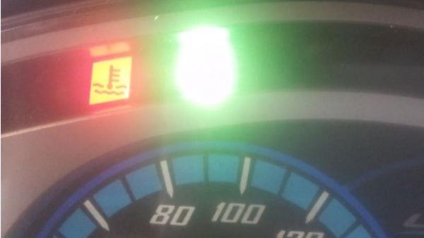

Recently changed my CDI, and this red temperature light keeps popping up ever so often. No issues with the bike.
Does spark need coolant or sth? I've seen a white holder on the right side with water like substance. Does this needs to
topped up? Someone kindly advice.
[ATTACH=CONFIG]300199[/ATTACH]
try changing back to the old CDI and see if the problem still persist. most of the time it is due to the TPS or thermo sensor.
spark does have a cooling system. if it is running low, chance are you are using it for too long as the reservoir coolant doesn't really drop that much. the manual recommend changing it every 2 years IIRC. you can try DIY coolant change. that the first DIY job i did for my spark:)
