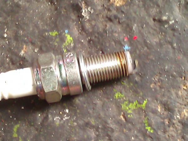

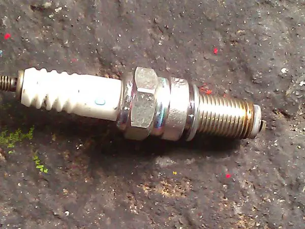

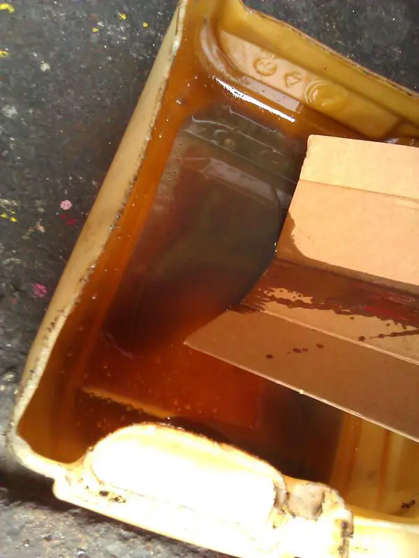

Just changed my spark plugs to Denso ($8) and transmission oil ($5) at an outside workshop (also a Kymco Workshop, but not from the distributor).
If they're right, they actually don't recommend Iridium for my DownTown 125i. Reason being -> Not needed for a scooter, waste of money, and it may actually bring more harm than good in terms of the sparking.
They change very fast though (mainly cos I'm the only scoot there). Took only 15mins (Gotta let the scoot cool down for a while to change the hot spark plugs). Haha.
Below are some pics:
(Transmission oil apparently grey color with "sludge" is very normal. If it's black color, then it's considered dirty.... Haha)
(The old CR8E NGK normal spark plugs I last changed for $11 at MS - they say the middle part is gone already. If I rode any further, the scoot may not be able to start. Was quite surprised.)
(New brand spark plugs changed for $8)
