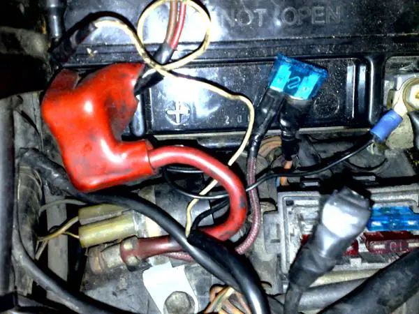

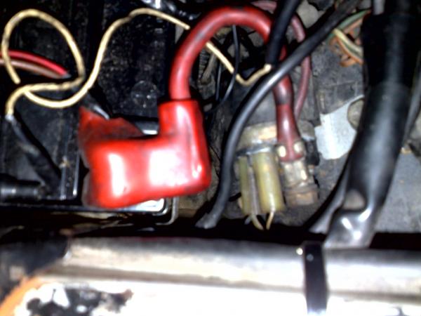

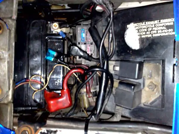

bros, i want to know what's this round thing that connect to the red (+) wire. k, when i press the start, only tick tock sound coming from that round thing, carbon starter no sound. bike just wont start. i want to know what's wrong before i can ask to service. cos the problem dont always come but once it comes, i'm damn jialat. need to count on luck to start it up!! where's the alternator? i think its the thing inside the round cover @ the bottom fairing. that cover was gone when i got into accident recently..
Hmm...
That looks like the starter solenoid.
I can see from the picture you've got 4 additional wires connected to the positive (+) terminal of your battery or the positive (+) terminal of your starter solenoid.
One of these is for your IU (white & black pair) but what are the other 3 for? Namely the red, brown and braided purple?
Now, if the starter solenoid receives insufficient power from the battery, it will; in your case produce a rapid clicking or clacking sound and fail to start the engine. The insufficient power can be caused by the following:
1) A low or dead battery
2) Corroded or loose connections
3) Damaged positive (+) cable from the battery
If the issue is intermittent, that might rule out your battery but do check your wiring. Your excess wiring may be the source of the problem.

batt just changed.
brown i think was for my alarm system but i told bikesop to take out for me already but dont know why the wire stll there.
as for the braided purple, its connected to the fuse, not to the (+). when i took over, its already like that, that fuse blew, bike cant start @ all.
as for the red, hahaha, till now i never figured out, thought it was headlights.
ok, maybe i'll strip it 1day to check everything out.
