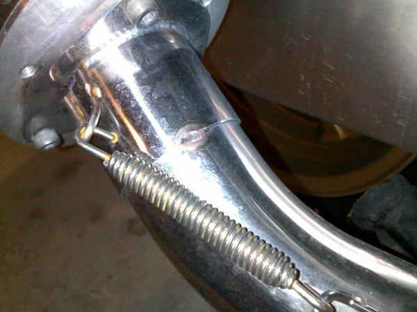

OK.. here's the tack weld pic. Hope its clear enough... Sucky E71 cam. Extra lighting also stil so bad.

Thanks for the pic, its clear.
But that will only stop ppl from stealing the adaptor rite? might need another 1 on one or all of the 3 bolts part connecting the adaptor to the endcan. can be done on request rite?

lyk dat ppl can still steal ur endcan lehh.. which is the priority.

Can be done. Got $$$ sure can do. Hahahaha~! For me I sometimes take out my can to clean my bike thoroughly. I was contemplating to tack my bolts as well the other day but I put the idea aside.
ya lor lidat no use man, endcan can stil get stolen
tat was y i didnt weld e can, Godsend got lotsa money, sud b no prob 4 him to do it :angel:
Wat i did was first to tighten the screws (real tight ones bcos even if ppl use vice grip to remove by the side, it will not hv the strength to break the torque), then covered up the ellen key holes with epoxy adhesive (once mixed it will b very liquidify, do wait for abt 1 to 2 min to harden abit first b4 u apply so it can stick nicely to the ellen key hole without drooling out, then cover the hole with masking tape to make the surface flush n wait for it to dry). Once the epoxy hardened, I dont even know how to dig it out also. Even can but it will surely take one hell of a time...
not a bad idea but tightening it real tight ones wont damage the screw thread?
No problem lah. Tight ones but not to the extend of breaking it :angel:

I broke one screw once on my Version S. Lucky stil got 2 more plus the end can band to hold my exhaust. Gasket prevent leaking. :)

hahaz.. no la.. i think u will agree be on the safe side is better rite.. hehz
Sounds chim.. but if can save money and does the same job.. y not?? :cheeky:

It works just fine for me...
Those interested can just try it out :angel:

bro, tack weld at most wil cost $50 but compared 2 losing a $800+ end can...which is more heart pain :dot:
hahaha tats wat im worried abt :angel:
if u dun know ur own bull strength n dun wana break d screw or damaging d screw thread, den another suggestion is using lock tight on d screw threading b4 tightening it 2 d end can n den seal up d ellen key hole wif epoxy like wat pngming suggested.
