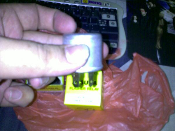

Attach ur relay...
This is my relay.

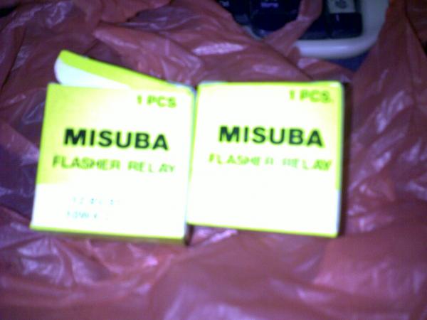

bros.. these are the 2 relays that i've tried and tested.. brought from LAB...
12.8v 85c/m
10WX 2+3.4W
same issue as above mentioned... :(
That relay if i'm not wrong is a heavy-duty relay...
