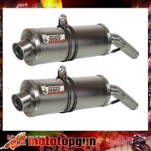

hey TDM brothers! Can i get an update on the 'climate' on the legal/non-legal exhaust in sg? As in are the men in white still clamping down hard on non-legal exhaust now compared to 2yrs ago? Was away for 2yrs...
Cos i'm contemplating on getting a quality, well priced exhaust online or buying an expensive legal one from shops here...
Off-hand, anyone one got a list of legal ones?

Quote Originally Posted by heaven51 View Post
My favourite is Remus Hexa...
There also from Yoshi, Scorpion, LV, GPR (that all I know from my knowledge)
Anymore that I've miss out for the street legal version... Bro Kmax pictures please...
Quote Originally Posted by kmax View Post
Termignoni alu -1700$ (race work)
Remux Hexacone - 1500 (motoworld)
Scorpion - 1300 (Equipment Extreme)
LV - price start from 800$ (alu.. many shops.. check with @Secret Agent for best deal)
and there are exotic ones line
akrapovic (loudest of all)
mivv
beowulf
ixil
laser ( best sound)
Spenx you are back!!! wow 2 years is a long time...deployed to combat zone??
If you want to get online, correct me if I am wrong, it is a hassle to chase the overseas vendor for formal documentation that Black&White states that this exhaust meets all the carbon emission standards or meets the TDM 900 specifically etc etc...LTA needs those documents before approval. No B&W=no approval..kifax managed to source an interest free installment from unique motor for ALU fyi
Thanks Bro, found the ebay seller that ships the exhaust with EU homogolation cert for TDM. I believe that is good enuf for LTA?
