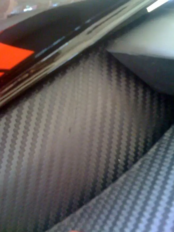

i pasted 3m CF sticker on my nsr150 frame. i nvr use hairdryer. maybe its due to my inexperience, i realise that even if u stretch it, for examples lyk corner or curve edge, it will still 'pop up' when its cooled dwn or as time passes.
therefore wat i do is to make a cut on the sticker at curve edge and overlaps the sticker. final result mite nt be so nice. but cant realli see 1. if im free tmr ill try to post pics.

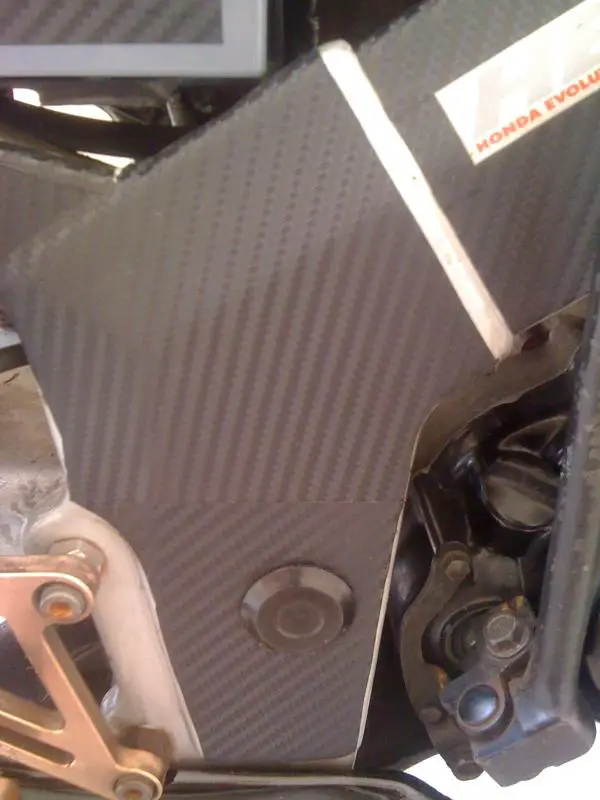

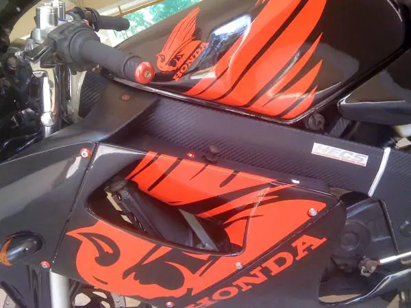

here r the pics ive taken of my bike
http://www.singaporebikes.com/forums/attachment.php?attachmentid=147431&stc=1&d=1267688648
http://www.singaporebikes.com/forums/attachment.php?attachmentid=147432&stc=1&d=1267688739
pic 1 shows the cut n overlapping not very nice tho. but frm far cant see 1.
pic 2 shows no cut frm a distance. due to time constraint tats y nvr go perfect it.
right side frame gt slightly improvement in sticker pasting. so the cut mark is not so obvious liao.

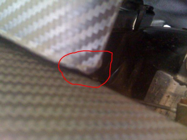

http://www.singaporebikes.com/forums/attachment.php?attachmentid=147435&stc=1&d=1267689007
http://www.singaporebikes.com/forums/attachment.php?attachmentid=147436&stc=1&d=1267689007
Enjoy!!!!

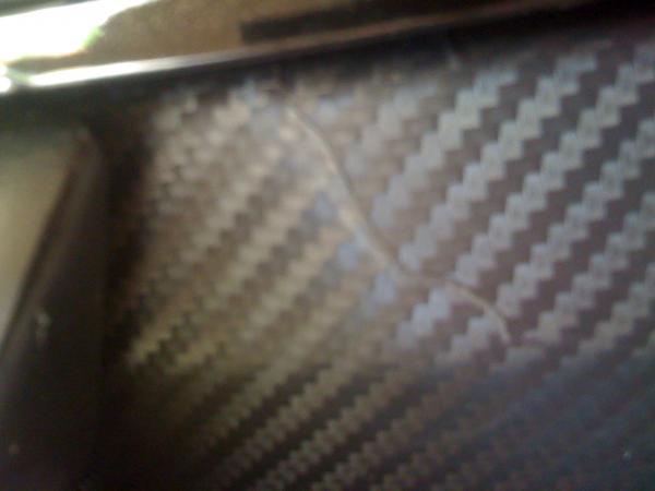

here is the 'pop up' even after stretching the CF sticker. might be my inexperience. tats y gt 'pop up'. pros plz enlighten if possible.
http://www.singaporebikes.com/forums/attachment.php?attachmentid=147438&stc=1&d=1267689361

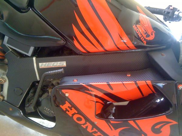

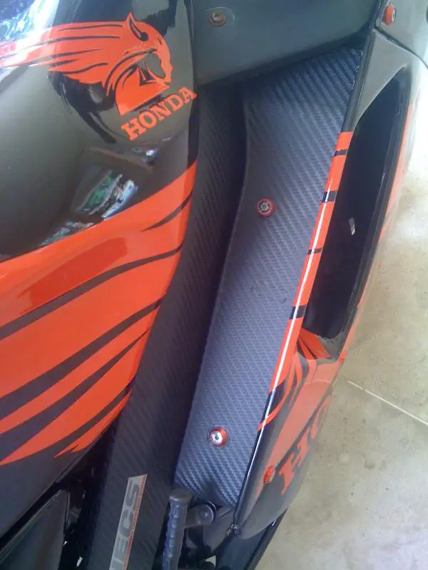

Finally, some pics 4 every1 to enjoy. the reason of nt CF-ing the whole frame is becoz some parts r damn difficult to paste, such as welding points. there are also damn hard to be sticked on. therefore, if anyone tries to DIY CF, plz make sure u haf at least the following items:
1) 3MCF sticker
2) useless cash card or phonecard to squeeze out air bubbles
3) glass cleaner to clean the surface b4 sticking
4) soapy water (optional) i skipped tis step and i duno how to work wif soapy water
5) pen knife, scissors
6) lighter (for smoking and heating CF. heat alr use phonecard to exert strength. this will help to paste the sticker easier on some curves)
tats currently all tat i cud rmb. anyone gt qns can pm mi. ill be very happi to help. coz DIY defintely gifs u the sense of achievement!!
enjoy the pics!!!!!!

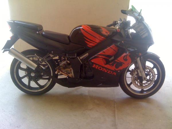

http://www.singaporebikes.com/forums/attachment.php?attachmentid=147439&stc=1&d=1267690180
http://www.singaporebikes.com/forums/attachment.php?attachmentid=147440&stc=1&d=1267690180
http://www.singaporebikes.com/forums/attachment.php?attachmentid=147441&stc=1&d=1267690172
