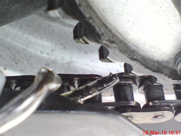

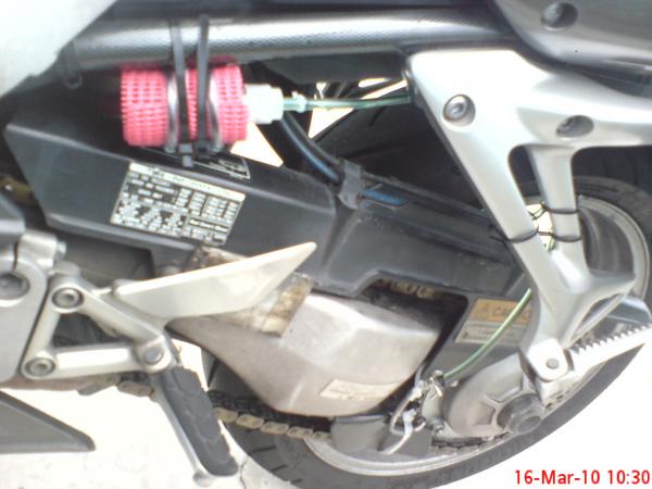

i get to find a person who installed an improvised "chain Oiler" on my ride when searching it on a local webbie. I tried it out & left his place happily. When reached home my chain is well-lubricated & shiny, except is it is already loose.
From his workmanship i was very satisified becos he is very particular abt the kit he is using also (my pt of preference) for the chain oiler. I had posted photos for reference so who ever wanna try it out can called/sms him.
I not trying to push business for him but those who r interested can contact him. Ezzyoiler knows who m i becos he said my bike is a thick & broad single-proarm & is a challenge to him. Juz tel him my nick MT23 riding VFR & he knows who liaoz.

Been using this DIY oiler Uncle koh created for the phantom knights for sometime already.. chain still as clean as new... condition of my sprocket and chain still brand new... Lesser wear and tear also....
Comparing using those can sprays and this oiler. It's far more better and quieter..

Been using this ezzyoiler for about 2 weeks already. Can say a simple yet good DIY product. I'm riding cb400 spec 1, saves me trouble of jacking the rear wheel just to chain lube. Somemore spec 1 no mainstand, so its really a hassle. Anyway, a sincere seller who took time to explain to me how his product works and workmanship was incredible. I've got NO REGRETS and Up for Mr Koh!! :cheeky:

No need to purposely clean, somehow the ezzyoiler's oil dispensing automatically cleans the chain due to the new oil. I've seen a lot of phantom knights' bikes with working DIY oilers; chain remains spotless after long convoy ops.

1. Color you gotto check with him, but from what i see, the bottle is transparent except for the rubber insulator thingy which is red in color. So if wanna change color, perhaps ownself spray paint? hehe.
2. The bottle is the container that stores the lubricant. So not necessary to refill everytime you ride. If i'm not wrong the bottle capacity is 50mls. So each time when you wanna ride, you can just pump 1 or 2 stroke of it (each stroke is about 2mls). Hence, there will be remaining of 46mls of lubricant inside the bottle. Whole bottle can last u say about 2 - 3 weeks depending on how much and how often u pump each time.
Hope this answers your qns... :angel:
