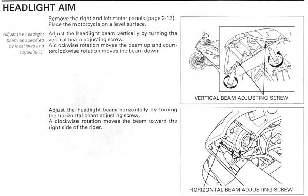

Do you guys find your low beam headlights aimed too high?
During the I first week that I got my bike I was rather puzzled at the stares directed at me until i realised that my headlight aim was too high. U can make adjustment of your headlight aim using a philips screwdriver. The attached picture might be of use.
http://i46.photobucket.com/albums/f120/inzaghi75/IMG_0550.jpg
The older 800FI don't need to remove anything to adjust the headlight aim. There are 2 built-in holes in the meter nacelle plastic, one for each lamp, to allow a long screw driver to be inserted thru for adjustment - altho you need to grope / feel about to aim for the adjusting screw - but you get the hang of it after a while.
