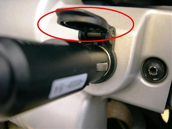

Hello BMW owners! i was told that the cig socket outlets on your bikes are the mini versions of the regular ones in cars? True?
If yes, where do you guys get your adaptors to fit the normal size cig plugs of handphone chargers and for other applications such as GPS?

True ... I got em adaptors from M-Teknik for $22 bucks.

This is probably what you need :thumb:
http://img.photobucket.com/albums/v198/Phang/DSCN5608.jpg
http://img.photobucket.com/albums/v198/Phang/DSCN5610.jpg
http://img.photobucket.com/albums/v198/Phang/DSCN5611.jpg
http://img.photobucket.com/albums/v198/Phang/DSCN5613.jpg
http://img.photobucket.com/albums/v198/Phang/3-2.jpg

Thanks Phang & Paul, but whats on the other end of the mini din plug?
I couldnt tell from your photos.
My socket is at a very unconventional location, around the knee area of the gear selector side. one of those sticking out when the bike is on the move is bound to be knocked out together with whatever that is attached to it.
But my guess is that mini din plug comes in only one size right? :(

As Paul pointed out earlier, you can get it from M-Teknik but you might have to modify it to suit your gadget.
Bro CMYRS, I think I saw a right angle mini DIN plug at M-Teknik too.

My R1150R '01 not even have the female plug as indicated in red. Color black. Anybody here have same missing plug. Is it removed by previous owner or certain batch come already without it? Had remove the cover but cant find the connection anywhere.

Hi Phang! I dropped by M-tecnik yesterday and bought the mini din male plugs. Eric said to cut the 2 wires to plug and play?
There was no right angle plugs unfortunately, need to make an order.
I was wondering, if its possible to have a male plug that has usb connections?
That way, I can just get regular usb cables for eg. mobile, mp3 etc and just plug them into the cig plug usb end. Instead of having to buy a diff cig adaptor for each item and then converting them into mini din?
Was told that usb connection might blow fuses or short circuit the applicance or the bike??:giddy:

There is such a cigarette lighter socket USB hub, but it is designed for car so not waterproof.
If you can solve the waterproofing issue (hide it underseat, tank bag, etc), it will be very convenient for all the gadgets.

There are waterproof car female plugs selling on the net. Go for the marine ones i.e. those installed on boats with O-rings.

yes! very convenient for all gadgets indeed! i have a regular car-usb one. all i need is a convertor from mini to big din and im in business.
but no feedback so far if this will fry the bike or the gadget??

Original accessory from BMW
Mini-DIN to Cigarette socket
Part number: 99990000058 (6 inches cord)
Part number: 99990000059 (24 inches cord)
http://www.ratwell.com/technical/SilverSocket/99990000058.jpg
Bro CMYRS, since you already got the min DIN, you can make one by connecting your mini DIN to a female cigarette lighter socket using a length of wire
