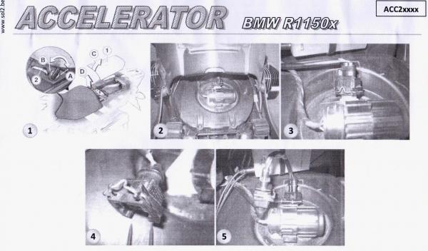

Any photo to show how the accelerator is install on the bike .
interested to install .
I have attached the installation guide for R1150GS hope it helps.
