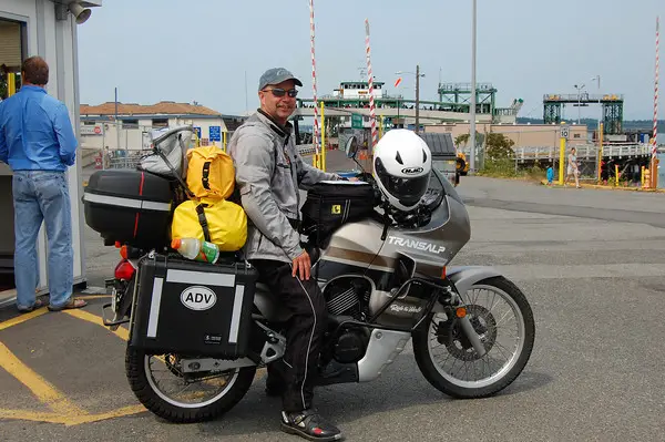

My TA!
Edited by NorCalTA
http://norcalta.smugmug.com/Travel/A-Transalps-Travels-4100-Miles/P1100146/355629626_ykS5u-XL.jpg
