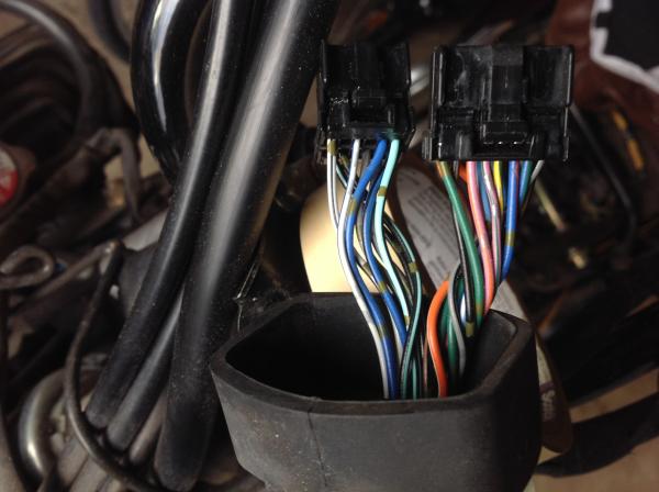

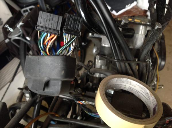

pictures of connection to rear of speedometer .i broke my 12 pin connector when removing.it broke due to ageing as plastic had become brittle.
pictures taken by B.J from silverwing600.com
FJS400 Speedometer Connection/Socket
happened to take down head cowl to install voltmeter the other day, so took opportunity to snap a pic :smile:
note: the wiring seems slightly different from the pic from silverwing600.com
SW model: FJS 400 (through Boon Siew)
Year of manufacture: 2006
http://i692.photobucket.com/albums/vv287/josephsbs/Silverwing/SWsocket_wiring_zps2890826c.png
Edited by scoobydoo
