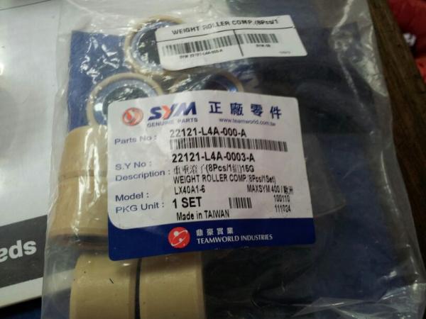

stock
Stock i think is 16grams
But i heard one person
Said is 15 grams
Definitely not 18grams

It's 15 grams. At least here in Portugal.
The service manual says 18, if I'm not mistaken, but that's an error. It also says that the Maxsym uses H11 light bulbs, which is another error...(it's H1).

Thanks for the clarification

Thks bro for the confirmation! Bike shop recommend me change to 16gm... 1 gm different. Will not do much change rite. Moreover is an increase in. Weight...

16gm is very similar to stock, but the pickup is slightly better with no loss in top end. im using 14gm which is perfect for local riding. very strong pickup and yet no loss in top speed, though RPM is higher most of the time, so FC will be affected. the stock 15 gm seems to be the best compromise. SYM has done a good job on this.
