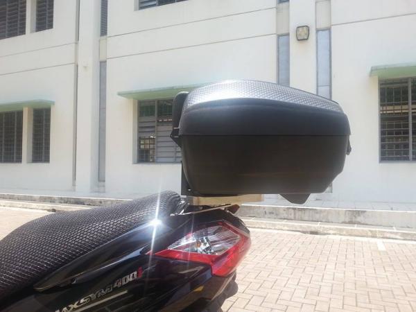

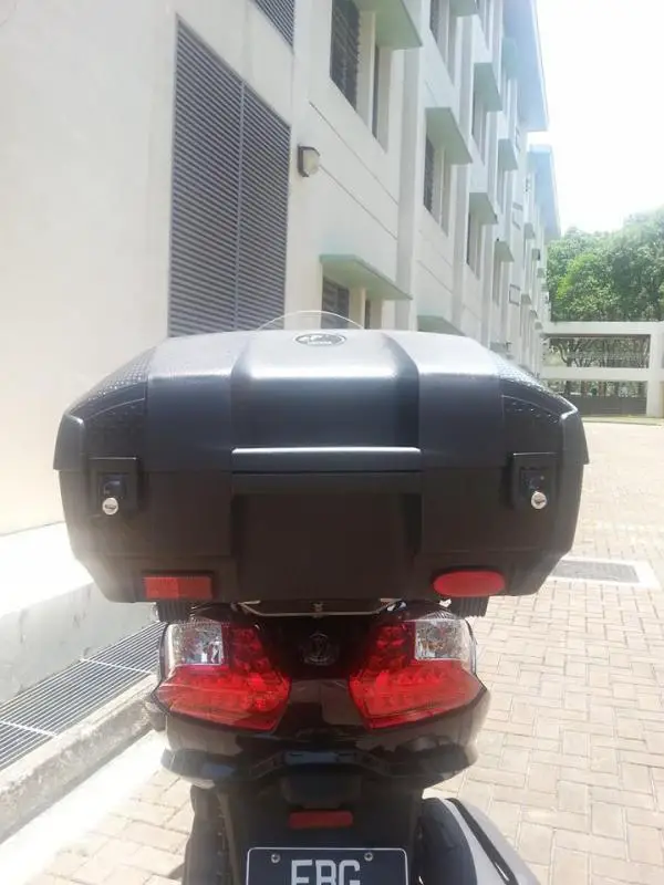

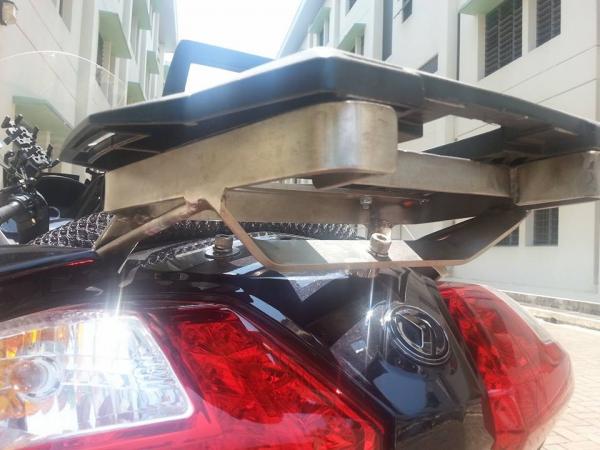

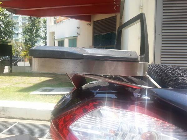

Selling custom made seng kwang rear rack with hepco becker universal rack. Can mount all hepco boxes. Seng kwang bracket cost me $300 to frabricate. Comes with lifetime warranty. Universal rack $120. Im open to reasonable offers. SALE DOES NOT INCLUDE BOX.
