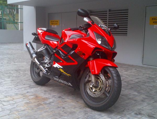

I installed a Scorpion slip-on on my bike in April last year and replaced the battery in July. However, I don't think the ecu reset helped...
There is this flat spot between 3000 - 4000 rpm and the bike will pull back or jerk during this range... its annoying sometimes. So I have to open throttle more to get out of this range to smoothen the acceleration.

The bike's a CBR600F4i... 01 model :)
