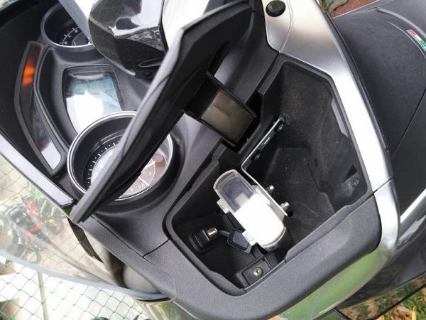

This seems like an outdated forum group. Anyway I'm riding a brown 350 since Sept 2013. I have been getting on-off electric start problem but nothing serious. Overall a good bike with good FC. Also I have mounted my IU inside the left compartment box. Managed queezed it inside there by dealer. Will post a photo soon.
Any issue with ERP car parks with your IU in the compartment?

I have no issue with any ERP carparks. The IU in that compartment works fine.

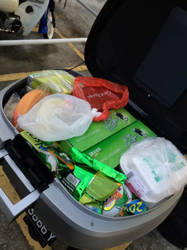

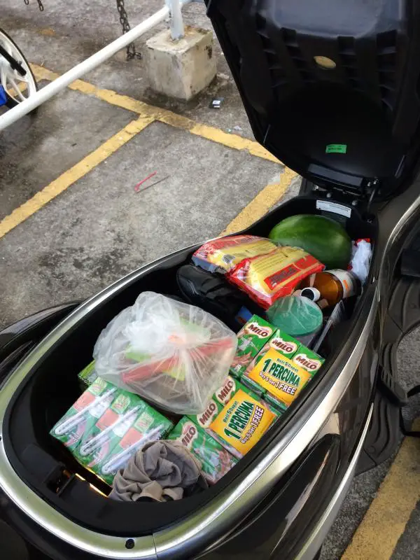

How much can you carry with X10? My grocery shopping ...

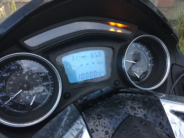

Hi, i have this msg (lo) on the instrument panel. Anyone know what is this msg about? I tried to surf the net and unable to find. Recently have some problem with accelerating at ard 4000rpm to 4500rpm, and occasionally engine dies off while moving slow or stopping.
Guess only ADH can decipher your error code.
Can take pic? Is it shown on the small LCD between the speedometer and tach?
Could be injector?
Do keep us updated ya.
Thanks.
Looks like ambient temperature sensor problem.

Just to also update, regards to the (lo) error msg: so far still trying my luck...these few days...so far so good. Called up ADH, need to send in and out for at least 2 days for them to diagnose. $80 for using the computer just to check...

Hi Kel5439,
The below are the list of problems likely and in following order :
1. The side stand kill switch could be causing the intermittent engine dying. You can get ur bike shop to disable the switch. (My current X10)
2. The right handle bar emergency kill switch , the internal copper contacts not formed properly also could be one suspect here. I had mine disassemble and Service accordingly.
3. The ignition coil and plug cable issue. You Could ask your bike shop have them change to a better quality one, current OEM one may not the best "QC-ed"
4. This ignition keyholes may the cause of your engine dying... I suffered this previously on my trusty X8.
I hope the above helps solve your dilemma.
