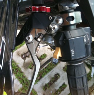

Unique dam ex man. Haha Me gonna sell bike dono whether clutch can use ma cause current owner don wan :D
chiong one lei... ex meh?
selling ur drz ah? wad clutch lever is that anyway? got try checking the part number out if it's eh gam wif ur fz6 or not?
I think that a ZETA clutch lever...:cheeky:
Yeah that's a zeta perch clutch lever. Haha seldom see people put nowadays. Normally people put flipable levers only. Haha the fat iu too big wan spoil it n change small de.
Motard very little people racing le most prob changing to supersports
