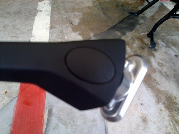

i rem someone is talking abt maintaining your fz1 mirrors right? is it @SiaoSter?
anyway, my 2 months old mirrors are as good as new...

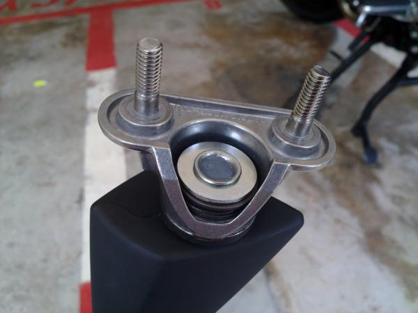

previously i only maintain it by lubricating it with sonax mos2oil at the metal moving joint...
anyway, today since i got leftover silicon, i had filled it up with them and i'm pretty sure it will further enhance the water from entering to the metal joint...
look at below pics for more illustration... cheers!
what i use to lubricate the metal moving joint...
http://www.mysonaxshop.lt/img/p/82-256-thickbox.jpg

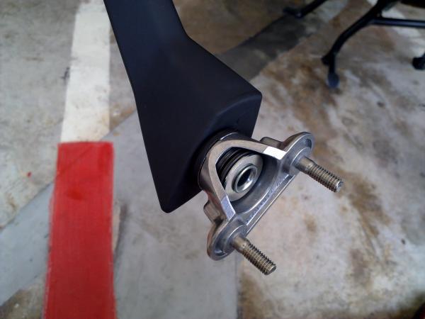

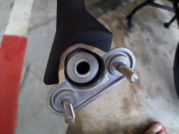

look at the joint and the area around...
it's as good as new thou it's 2 months old only!
http://www.singaporebikes.com/forums/attachment.php?attachmentid=176551&d=1285545661
http://www.singaporebikes.com/forums/attachment.php?attachmentid=176552&d=1285545665

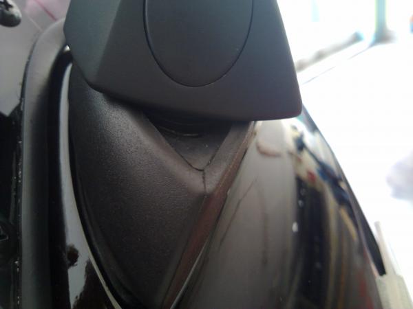

discovered there may be possibilities of water entering thru this cover...
http://www.singaporebikes.com/forums/attachment.php?attachmentid=176550&d=1285545657

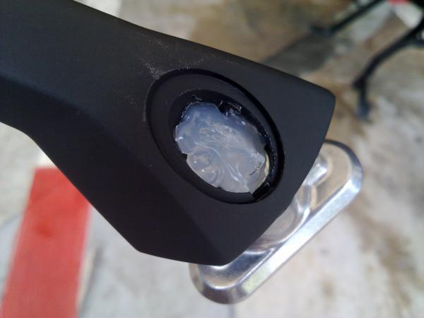

so, filled it up with silicon!
http://www.singaporebikes.com/forums/attachment.php?attachmentid=176555&d=1285545676
and fill it up till the other end of the hole...
of cus, pls do not fill up the area including the metal joint... lol...
http://www.singaporebikes.com/forums/attachment.php?attachmentid=176554&d=1285545672
lastly, fyi, if u r those who park ur bike in open air area and weather do not permits, pls do not close ur mirrors...
if u do so and by doing this, u allowing direct access to the rain to touch ur metal moving joint...
http://www.singaporebikes.com/forums/attachment.php?attachmentid=176553&d=1285545668
good luck to all! cheers! :D

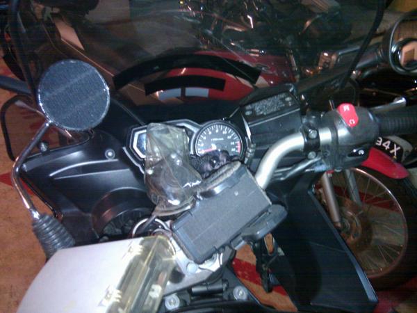

his number plate, i think is 63xx, IF i didnt remember wrongly. yeah the bike i saw box set up is like that.
anyway i took a pic of his handlebar area.
oh... that's not him le... recko's number plate is 3 digits de starting with 5xx de... :D
oh icic.. this bike i saw had a 12v cig charger covered in ziplock and a phone mount which was mounted across the bar where the big clamp was. but his stock big bar clamp was replaced by the normal 2 piece ones.
