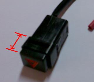

Then I prepare my switch
http://i109.photobucket.com/albums/n64/nemo6089/Image003.jpg

@reborn - Btw, the cutout that you made should by for the lower portion of the switch rite? Otherwise when you press on it, the entire switch will sink it ya....
WHich means that the switch is pretty elevated?
http://img.photobucket.com/albums/v416/urylle/284668.gif
Biting on the fray of my hair, I muse upon the way to find the oasis of evermore beyond the vertical horizon, I shall join the windupdeads in owl city, neither my safetysuit nor my red jumpsuit apparatus can save me, cuz I mistook a death cab for cutie in plain white T's...
think not..on the switch itself got a convex layer which should act as stoper. look proper on the pic that reborn posted. :smile:
Yep, expected it to go to that level... So the total protrudsing surface should be as such right? Which is quite elevated woh...
Omni, you are right, the switch cannot be flush on the plastic due to the catch on the switch is quite low.
