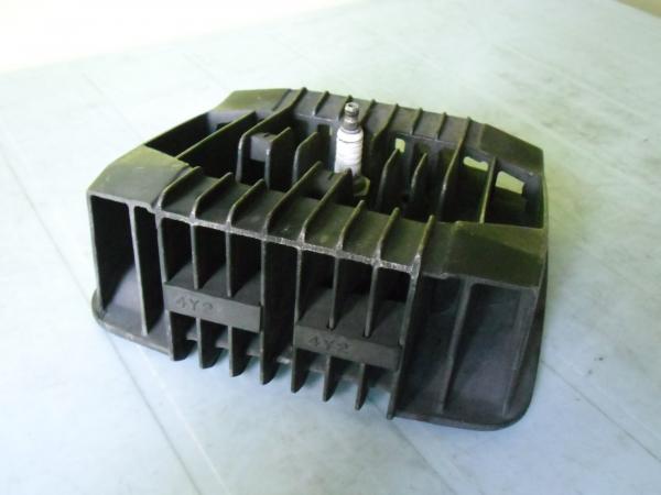

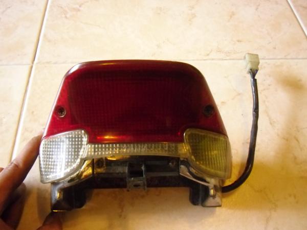

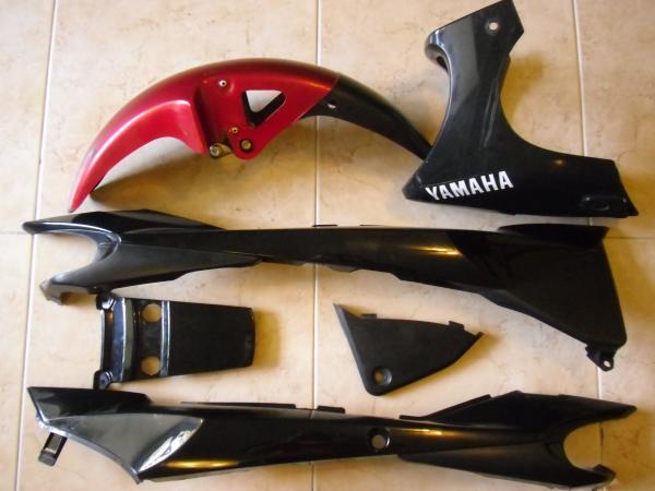

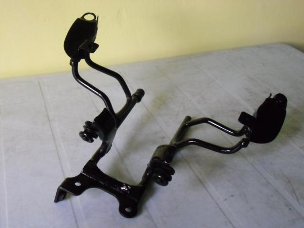

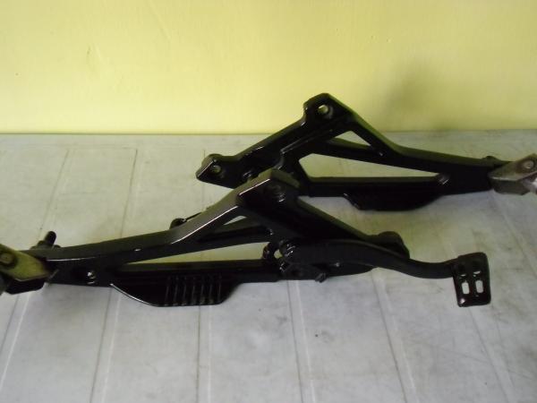

Hey guys.. Letting go of whats left of the RXZ parts that i have been selling.. Pm me if interested thank you!
(all original parts)
Y2 block head $25
seat-$10
head faring bracket (catalyzer) -$10
2t pump and reserviour -$15
foot rest (one pair including the foot peg (new) ) -$30
horn with bracket -$ 10
(Local stuff)
black side farings and belly pan -$20
Prices are nego
