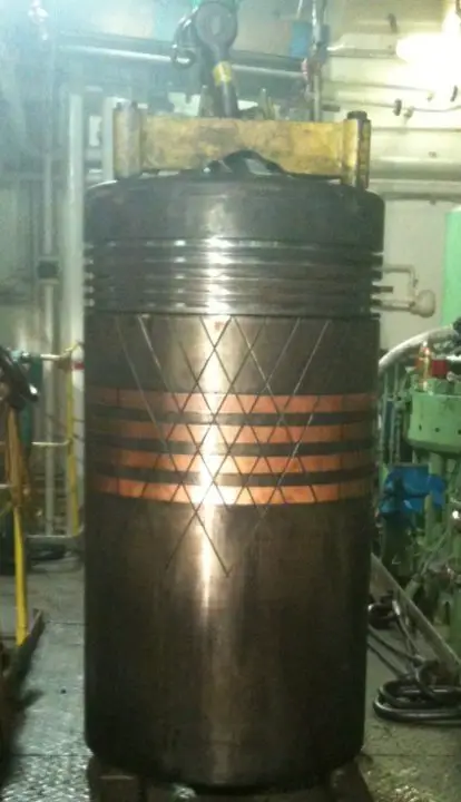

Oh... I think over here, they won't know till they open up the block and see the piston size I guess. So yeah...
Anyway, I've been runnin my Z wif a really, REALLY oversized piston and they hav yet to catch me. Tis tis the pic of my piston before placing it in my block...
... Yeah, I think it's size is 999.75 and u need a crane to hoist it in. Almost to it's max size alrdy...:angel::p:faint:o_O:):cheeky:
[ATTACH]150828[/ATTACH]
haha. this one ship engine piston siol
