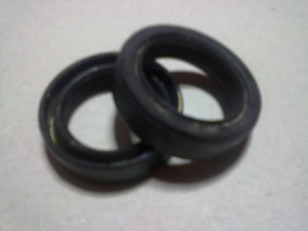

Hey guys,
just wondering. Ive just done front fork servicing including a change in oil seal and the mechanic not putting this circular part into the fork back after fixing. Is the circular thing need not need to put? Bike RXZ btw.
Hey guys,
Tat would be the dust seal. I bet u alrdy noe wat tat thing is for from it's name...:thumb:
