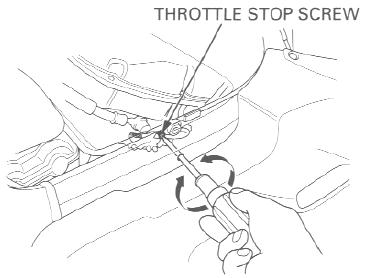

anyway what u guy idle during cold start and after warm up ?
my idle quite hard for cold start, after ride out 1.5k
Edited by MrIce
pressure: F 250, R 290.
idle during warmup is 1.5k rpm, after warmup ard 1.1k for mine.
Tyre front 36 PSI ; rear 42 psi.
Idling should be be 1200rpm. On yr 5th gen, there is a small hole (approx 5mm diameter) on the right frame spar that is covered by a rubber plug. Remove the rubber plug and insert a flat blade screw-driver and try to feel for the adjusting screw. Turn it anti-clockwise to reduce the engine speed.
