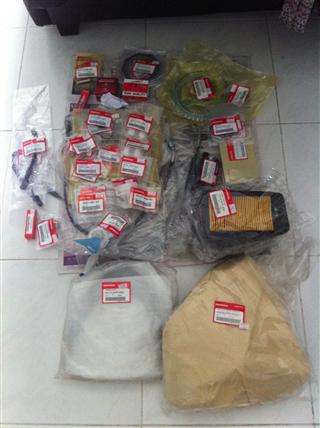

hi, sorry i know i have been posting on and off, anyway the shop Hou Heng is my frequent shop. It has been that since my first bike(2009) anyway I wanna share my latest lobang with fellow CBR riders
I have established contacts in thailand to purchase original Honda CBR 150R parts including fairings. Also on my previous post I also got bearings set for the whole bike from the german company FAG.
Ah-Di the boss is very happy to install the parts for you with a service charge. But of course you have to buy the correct parts lah if not god also cannot install for you.
You can PM me if you need parts and maybe we can mass order together to save on the parts and shipping.
