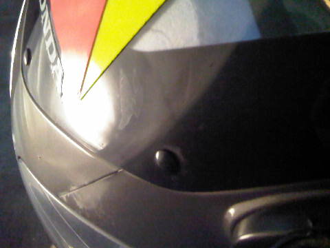

its actly nt rivet. its something like rivet which has no screw head
[ATTACH=CONFIG]245221[/ATTACH]
the black colour thing, thats what i mean. i turn and turn nv come out. only way is to pry, but scared ltr spoil cant put back, then i wont hav any windshield l o l
remove the meter assembly and have a look what the other end of the rivets look like.
should be able to push/poke them from inside out
