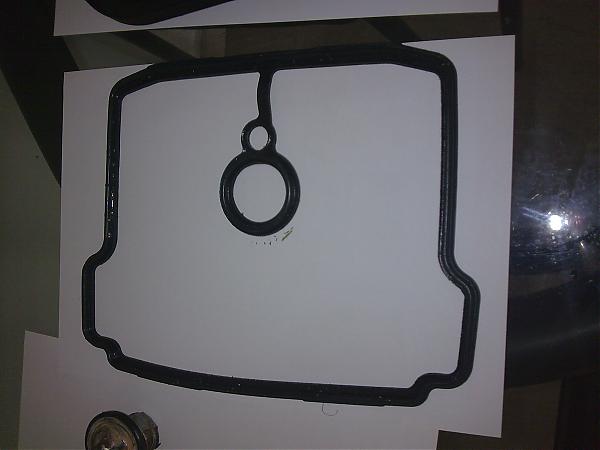

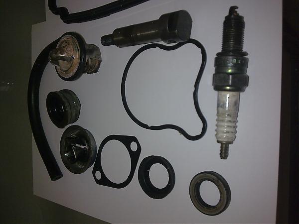

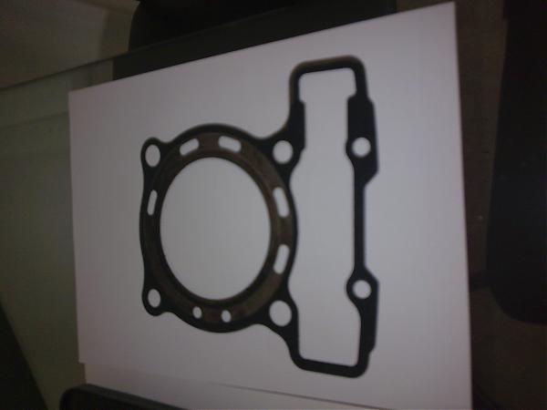

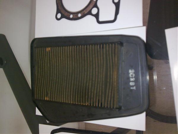

HI.... I just get my bike back...
There the part i replace as attach...
But now still go some problem... Engine Oil Leaking.... And when clutch-in to early the engine will die....:cry:
Anyone can advice...???

Er, for clutch in nearly die, i think the carb tuning run off liao? Maybe need to open carb and wash and re tune lo, then again i might be wrong.
As for EO leaking, where leaking which part? AT the bottom or some random place at the side?

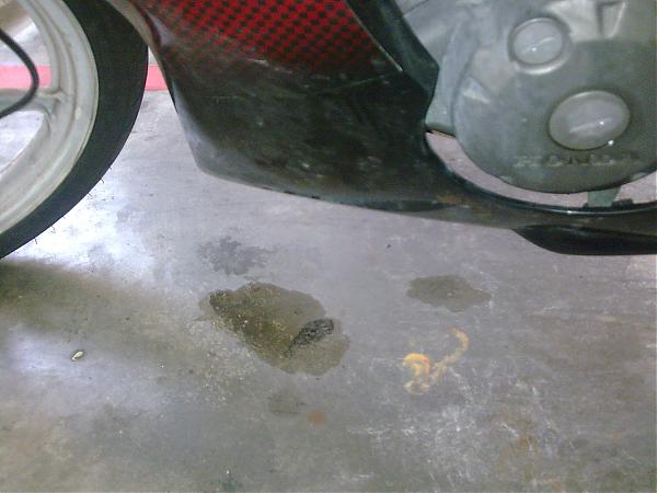

Engine oil leak under the fairing .... everytime same place de....

that place looks like near the drain plug. the plug got plug in properly or not?
or might be crankcase gasket crack or leak?
and please stan.. WASH YOUR BIKE, while washing can bend under and see whats wrong.... zzzz:dot:

how to know whether ur bike is leaking engine oil or overflow??

remove the side + bottom fairings. wipe clean yr engine crank case (both sides and bottom) then u proceed for a ride. if there is a leak, shouldnt be too difficult to spot oily spots bah.
alternatively, to confirm it is not an overflow situation, i guess u juz need to trace the overflow hose frm engine crankcase. it is somewhere near to bundle of other hoses at the bottom centre of our bike. if u were to peep under the right footrest u will see them. cable tie a puny plastic bag or piece of cloth to the end of the correct hose and take yr bike for a ride.

correct, if EO leak or over flow, is one of the several drain pipes at the bottom of the bike. If i not wrong mine is the one the tube is covered one, and i think i have a few over flowed EO in the tube, its kinda gross, its like become grease liao. I think thats the one.

Thank don... i will take a tissue and rubber band try...
