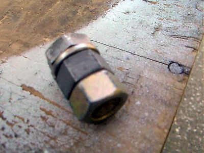

There is an old trick.
Get a bolt with hex head that fits your axle's inner hex, double nut it so that you can use a normal wrench/spanner to turn it :thirsty:

Thanks for the idea, I google and find that I can use a hex end of a socket then fit a extension bar to loosen the front wheel axle.
