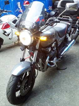

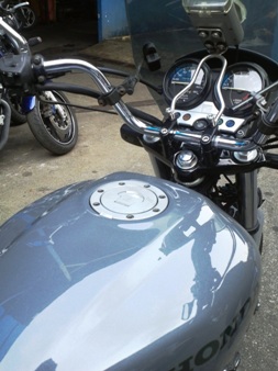

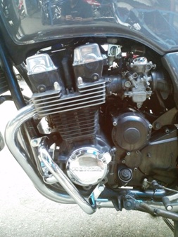

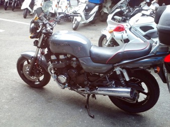

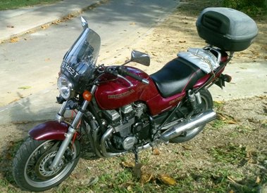

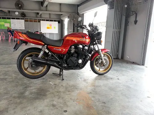

Thought I'd share some pictures with you guys. My bike started life as a 1998 CB750FIIN (RC42) JDM. She used to look like this:
Standard maroon paintwork, utilitarian box on the back. The only mods I did were to add Motovation bar end weights (the heaviest I could find, to try and reduce vibration levels) and add some foam to the seat (had it done for $60 at Eugene Saddlery).
I got bored and decided to jazz up the bike a little. Some of the stuff I did...
1) Polish and clear-coat the cylinder head covers and some of the engine covers
2) Open up the exhaust for a more throaty sound (http://www.nighthawk750.com/mods/exhaust.html)
3) Add relays for the headlight and a master relay for all the electrical power (purchased a Spec III headlight for $70, brand new, from Ever Success Auto Parts, near Mustafa)
4) Bypass the rotten main fuse and fit my own waterproof fuse holder (http://tuniyama.blogspot.sg/2009/11/updates.html)
5) Convert the signal lights to LED; convert the brake light to LED (http://tuniyama.blogspot.sg/2012_09_01_archive.html)
6) Swap fork springs over to HyperPro progressive springs (US$100, a friend couriered them home for me)
7) Add LOUD horns (From tuniyama.blogspot.com)
8) Rebuild the rear shocks (BikeLab)
9) Repair broken RHS side cover and paint the bike in Mercedes E200 Metallic Grey (Ban Hock Hin, http://www.banhockhin.com.sg)
10) Powdercoat forks, swingarm, triple clamp, wheels and other bits and pieces in gloss black (David Kong @ Weng Wah, #01-464, 11 Defu Lane 10 (S)539192 P(6287 5086))
11) Fit SSDC CB750 High Bars ($50 from FJT Parts) for more comfort
12) Braided brake lines by STAR, extra long to fit the high handlebars ($150 including install from Ban Hock Hin)

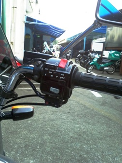

13) Modified XJ900P Police RHS switchgear so I can use the switches to run fog lights etc (Ban Hock Hin)
14) FEHLING crash bars from eBay
15) Forks modified to allow adjustable preload (spares from eBay)
16) Chromed carburettor parts (David Kong)
The LED conversions and horns were done by Tuniyama Industries (Ah Bear, 93658648). No super-quick flashing that is common with LED conversions because he supplies a modified LED flasher for use with the LED signals.
All other workmanship done by Ban Hock Hin.
Here are some pictures. Enjoy!

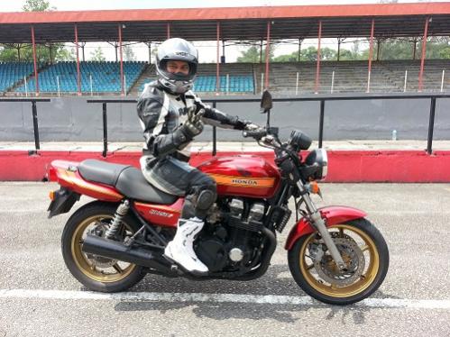

Hi all,
New member here. Nice to see this thread getting lively again. Been riding the cb750 for abt 8 months now. Not the best of bikes, but sure is a superb all rounder. Use it for daily commute to work, upcoming tour and the odd trackday.
Been reading all the mods u guys been doin. MJ just fix a higher bar, but im actually considering a lower one, not streetfighter style thgh. Anyone here fix a super4 handlebar before? I know that with a lower bar, there's risk of the handlebar hitting the tank on full lock. So i think the S4 handlebar with its 2" rise would be just nice. Also am thinking of replacing my "cheerful and lively" rear shocks.
So honk when we see each other on the road...
Some pics:

All bikes are track worthy so it's not odd to track it.Well done bro.
Hi Mattel;
Your bike looks like a CB750-RC42 'L' which is the model that SSDC used to use. It's got the hydraulic clutch, bigger oil cooler and blacked out engine and exhausts typical of the type. You're using the same high bars that I am currently using. You can fit the lower bars with no issues at all, there's plenty of clearance. What you can do is fit the lower bars, but put in a 1" riser; that will allow you to rotate the bars further back without the lowest part of the bar hitting the tank.
Junk the stock 'L' shocks, they are not up to the mark; fit a set of good Progressive, Ikon or Hagon shocks. Good value for money. The stock front springs are horrible; you can get Hyperpro springs from overseas for about $100 shipped or you can order up the springs with your shocks from Hagon or Ikon.
To give you some ideas for your machine, check this article out:
http://teamrc17.net/articles/103/zephyr-zapper
Cheers;
MJ
