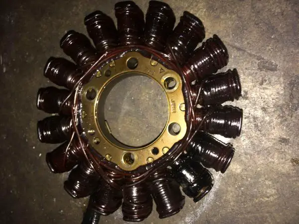

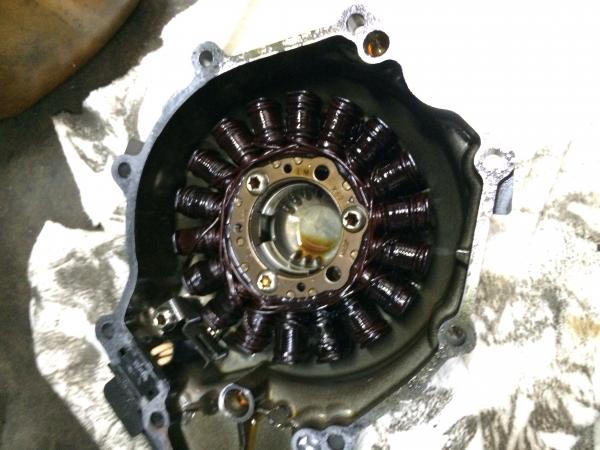

My stator is beyond salvation right guys? Haha
[ATTACH=CONFIG]292609[/ATTACH][ATTACH=CONFIG]292609[/ATTACH]
cant see clearly....
