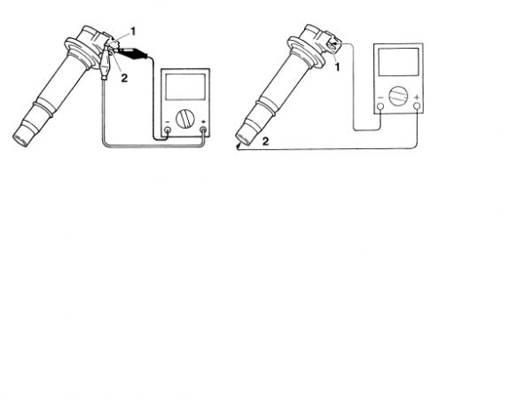

some pointers for ppl who hv coil problms:
CHECKING THE IGNITION COILS
The following procedure applies to all of the ignition
coils.
1. Check:
• Primary coil resistance
Out of specification → Replace.
1.19–1.61 Ω
• Positive tester probe →
red/black
• Negative tester probe →
orange or gray/red or orange/green or
gray/green
a. Remove the ignition coil from the spark plug.
b. Connect the pocket tester (Ω × 1) to the ignition
coil.
c. Measure the primary coil resistance.
2. Check:
• Secondary coil resistance
8.5–11.5 kΩ
red/black
spark plug terminal
a. Connect the pocket tester (Ω × 1k) to the ignition
coil.
b. Measure the secondary coil resistance.
3. Check:
• Ignition spark gap
Minimum ignition spark gap
6.0 mm (0.24 in)
