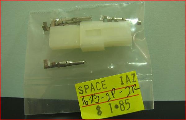

You can buy this connector at SLT. I had done this for my bike too.

thanks for the replies.. went to bike shop and get it done..
PK Leong your connector looks much more convenient to disconnect.. mine is 1 male 1 female..

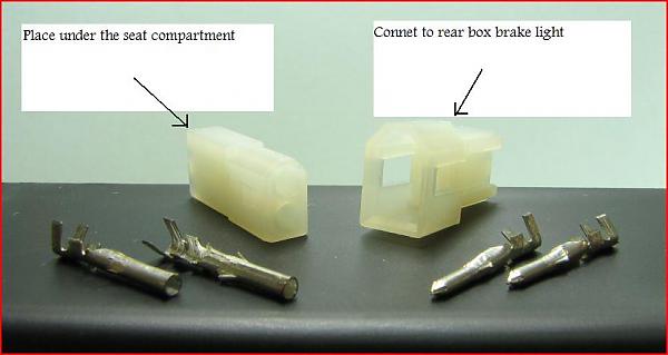

so what i should do is get male plugs and connect it to the wire from batt and female plug from light to wire then it will work already right?
I strongly suggest you connect the female plug to the battery and the male plug to the box. If you do it the other way (male to battery, female to box), unless you have a cap to cover the male plug if not the male plug will touch the frame and fry your wire/burn the fuse if you have installed one :)
