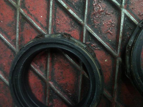

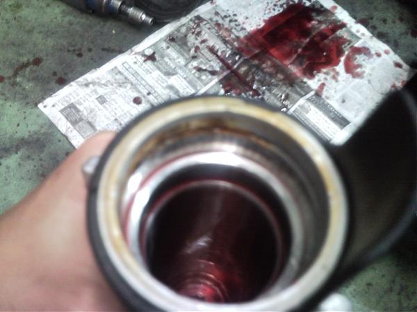

Hi all
For those whose dust cover for the front fork is bulging or out of shape. Please take note that the seal maybe broken and that damage is being done everytime u ride.
Attached are some of the pix i took when i changing the dust cover and seal.
Take heed of it. The rust is very corrosive.

Hi all

Wah! yours so fast change? Maybe my method of canvas bike prolong it...will do my change next yr....its part of my yearly maintenance ordeal.

Somehow water seeped into the dust cover and rusted the whole thing. Covered my bike though dunno why it happen also. But will keep in review wherethe it is the way i store my bike or how i ride that attribute to this.

Yup flareon , happen to father's bandit,probably due to washing or heavy rain mah,the rubber gasket after a while will harden depend on wat shampoo and all those sun basking,even though it's new and flexible,doesn't mean it keep all the water out.heehhe...thks for the shring of pics.so i noe wat will happen later.thks though:cheer:

How much u kena for the fork seal change?

150 for Seal, Dust cover and Oil.

once you see the cover bulging out than thats the time to change. If u find out early, you will only need to change the cover. If delay than like me change the whole thing......
Bulge a little will means that the cover is spoiled. Any more than that means $$$ flying. And the longer u take to repair it, the more $$$ gonna fly.
End of the day. Just change fork loh.......
