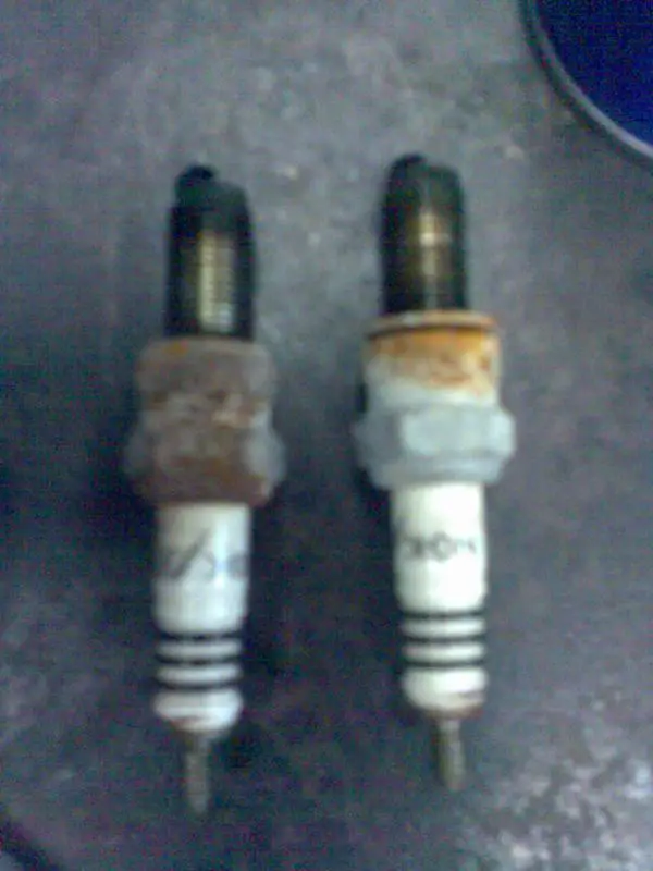

check out the plugs on att.. this is an idea wad dzal is talking abt. not all 4 plugs are equal. the other 2 was okay.
Oem plugs r a nono. proven by riders who had bought it b4. cracks here n there, or chip/broken, worst off the tip broke n cause a piston jam..
Wah! whose bike was that? The plugs looks very worn out. See see never take care and check/inspect plugs often. To me I will stick to my idea of taking out plugs, do a bit of maintenance and put it back.

Those look like they simply failed. Either too lean (and conversely too hot till the plugs are burning off) or the plugs are corroding from integrity failure.
alamak brader, which camera u used la...gue kena pakai binoculars untuk tgk beb ( i must use binoculars to look babe )...lol
dont worry la, new technology bike like ours, d spark plug wont rust. like what wildcard mention, its too lean and when its too lean, ur spark plug is hotter than normal.. thats when the ceramic give way and everything else too...
be like razi, Scheduled PM, but add another step, change the sprak plug when taken out.. its cheap $7 per piece...
