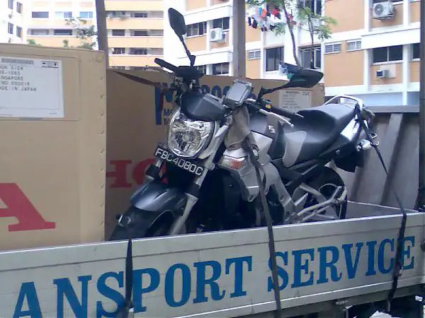

send my bike to loois this morning... 0953hrs... waited for abt 4hrs as the guy 'went' to search for the CDI...haizz... no have...
2 option was given....
1- airfreight.. within 1 week...cost would be ard 1k... haizz...
2- relax, as they will bring in... meaning 3 mths my gal will be in workshop...
abg ahmad said he tried talk to towkay, if he was willing to swap a maybe 2nd hand CDI with me.. which i doubt so..
im so heart broken.... as i awaits for his news...
anyone out there who has SPECIAL lobang for the CDI... please do contact me... 93213570...

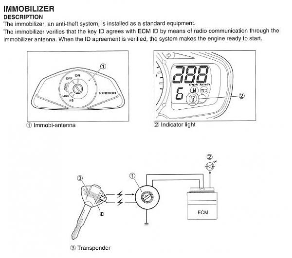

Bro, sympathize your plight.
But I gotta raise this:
CDI or ECU?
I do not recall the GSR has a CDI.
The immobilizer is connected to the ECU only.
Refer to the attachment below.
To my understanding, its the ECU that controls spark timing.
CDI or ECU?
Now, if its only ECU....

Cant they bypass the immobilizer thing, then call those "key specialist" to make clone key for your bike.
No,
The feature is inbuilt in the ECU.
Kinda difficult to do a bypass.
The immob unit matches with the key. After that, it will send a signal to the ECU to indicate its safe to start.

If so, then cant buy alarm with auto-start functions.. :(
No, you can install an auto-start alarm.
The problem lies with not the immobilizer unit but the clutch.
Remember that you have to clutch in to start the bike?
How to auto-start?
Technically you can. Bridge the clutch switch cable.
But it is suspected it will affect startup in an unknown way....
