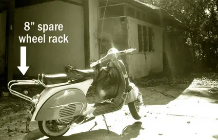

Hey guys. I'm new here, Am from Malaysia(KL). Has been planing to make a trip to Singapore for quite sometime. I'm currenly riding one of those Vespa Super 8" wheels model. But there's an alternative to it. Just put in a bracket in the middle of the rims to convert it from a 8" to 10". For my case, I've been swaping between the two sets of rims for diffrent rides. Usualy i'll keep my 8" when i'm in town, and swap for 10" when i'm going long distant.
