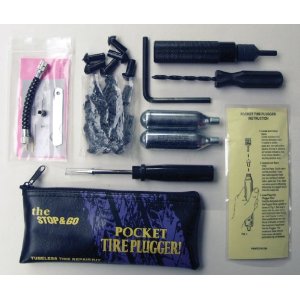

Bro ramsnake, the 'plug' mushroom head wil all the way stick dere or it wil drop off eventually.
Cuz I few days ago tot tt its a chewing gum and I tried to pluck the mushroom head. Bt stop halfway cuz I nt sure whether it is the plug or nt.
Wil it affect the tyre?
The picture shows the whole repair kit though the ones sold in SG (Motoworld) doesn't come with the CO2 canisters. The Plug is shown at the top, with the allen key on it's right.
The "mushroom" head goes inside the tyre, leaving the stem protruding out of the tyre thread. Pull the stem to properly seat the head around the hole inside the tyre. Then cut off the excess stem close to the tyre thread. After riding for some time, the stem will wear down to the same level as the tyre thread.

Ohhh tks bro ramsnake for the info.
Nw I can cfm n believe the sticky ting on my tyre is nt the 'plug' cuz its a big black patch 'like' chewing gum and size of a 50cent coin stick on the surface of the tyre.
Such a unlucky tyre.
